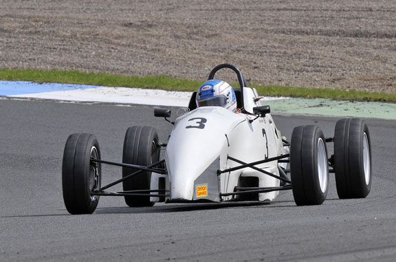

Apologies for the lack of pictures (hasn't been at the front of my mind), but here's a pic of the car from last season to remind what I'm talking about:
