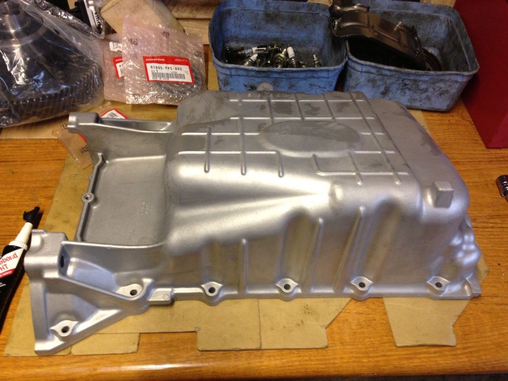

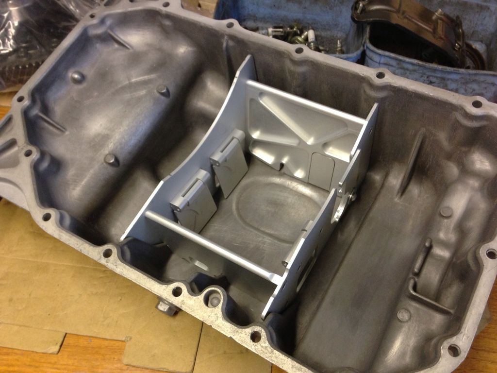

I managed to use a shot blasting cabinet locally to blast the sump that I recently got off ebay, as the later Z spec sump is much deeper and wouldn't allow the undertray to fit if I stuck with it. It was pretty scabby when I got it and not much better after I paid a tenner for a place in brum to supposedly blast it. Looks nice now though.

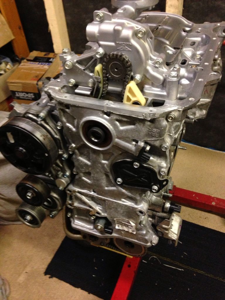

Also got my baffle installed now....

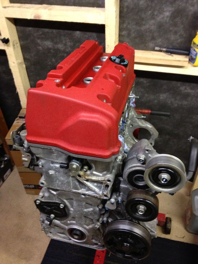

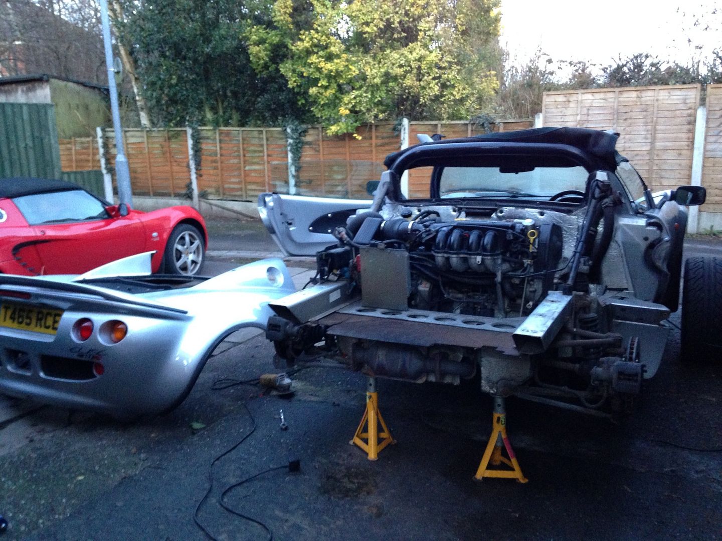

Timed the engine in and put the side back on...
Hey presto it looks like an engine again...

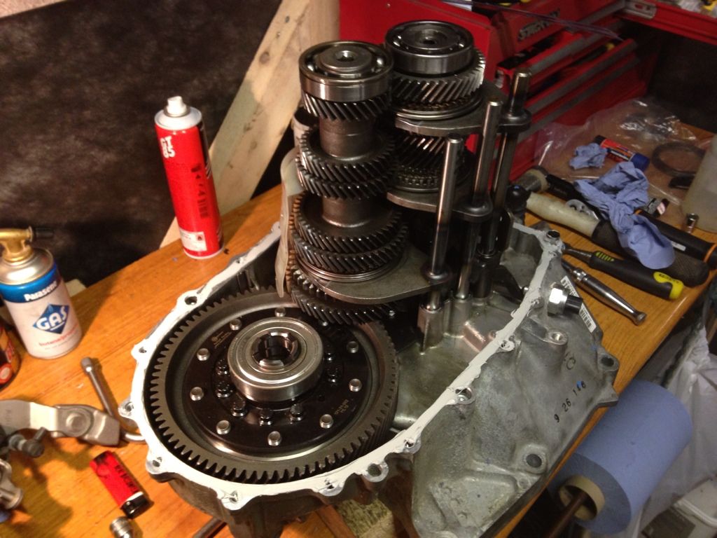

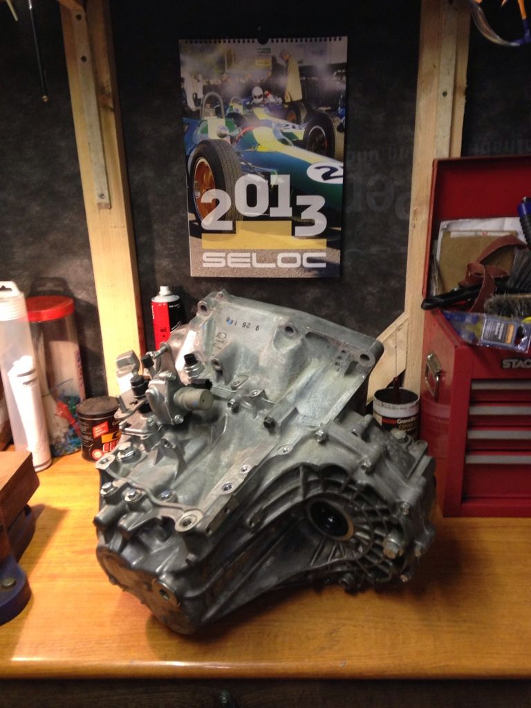

Tonight's update - gearbox finished, engine and box ready to drop in the car :D
Heres the wavetrac diff and gearset installed in the case
Thankfully the diff shimmed up perfectly, so no messing around with different sized shims required. New diff bearings have gone on as a matter of course.
Gearbox complete...

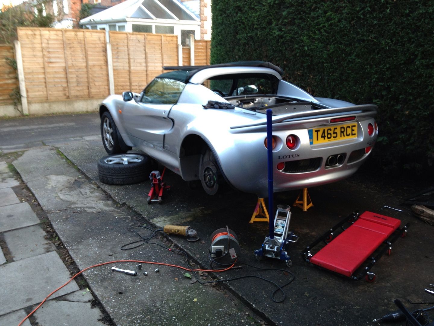

Started the exciting bit today...
Only two captive nuts came free requiring some easing with the angle grinder, not too bad I thought.
And here it is on its new trolley in all its glory :D
You ought to be ashamed of those rusty wishbones.
Oh I am. All the wishbones are coming off and being blasted and powder coated 8)

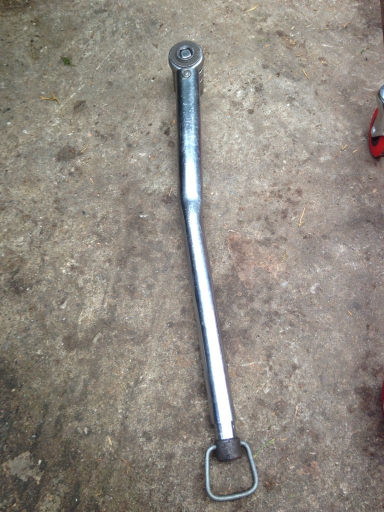

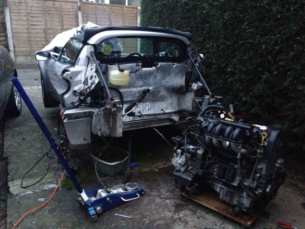

Well today didn't start terrifically well after I bent my old torque wrench trying undo the driveshafts...probably time to ease off the gym :lol:

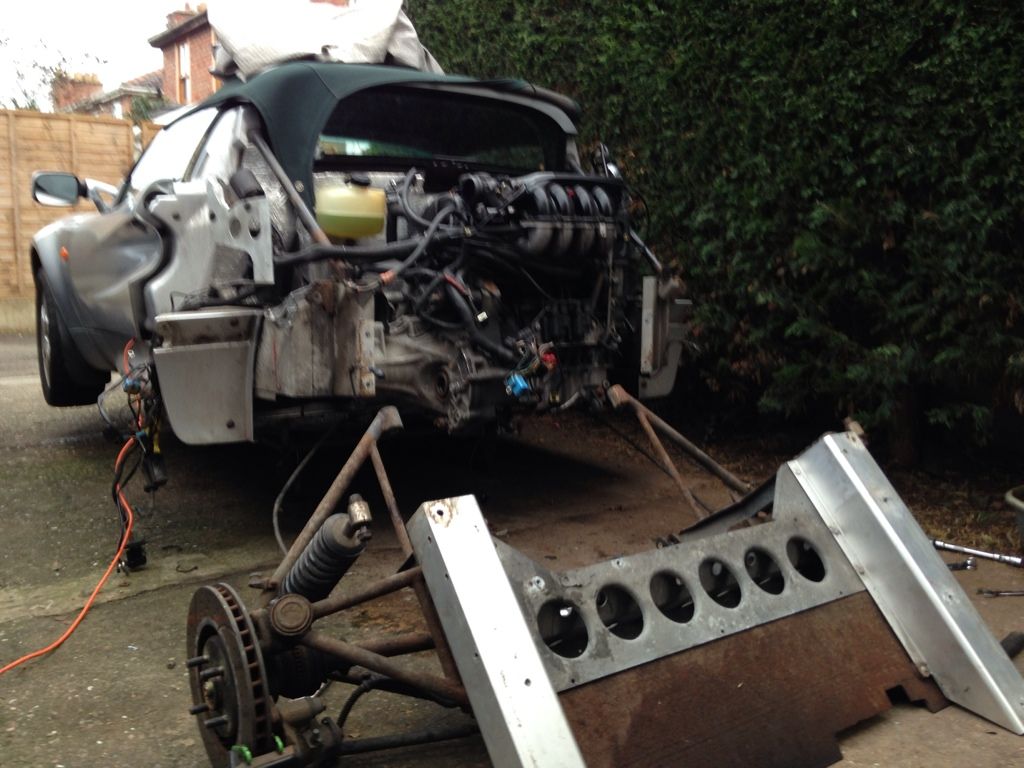

I therefore decided that the best course of action was to remove the entire rear end fully built up.
From there it was a pretty easy process of disconnecting everything and draining the water.
Before dropping the engine out on another little trolley i'd made, I'm getting carried away with castors I think, I should stop before I fit two to the rear of the elise when its finished :D
Thats it for today, tucked up for the night again...
