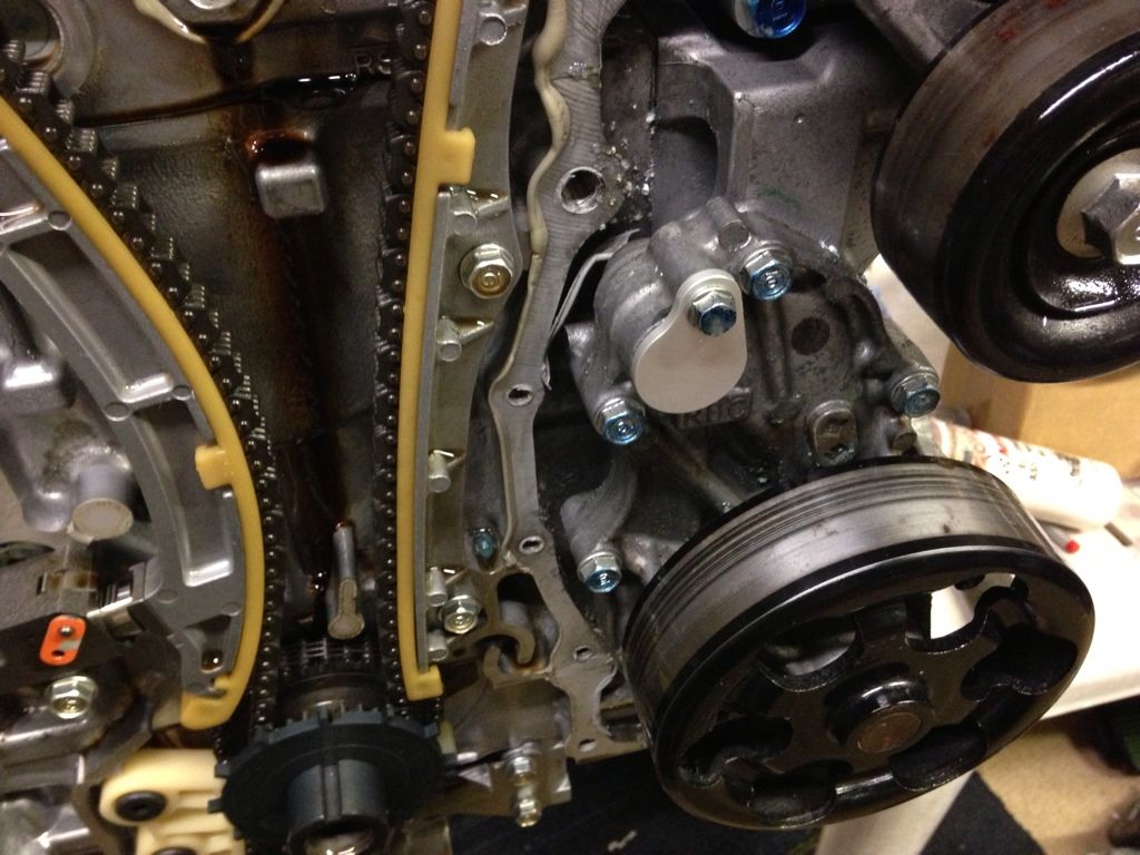

The damper had a chunk missing from the outer ring, the guys balancing it said you'd expect to have to remove some material from the opposite side to get it to balance, but actually this is what was required.

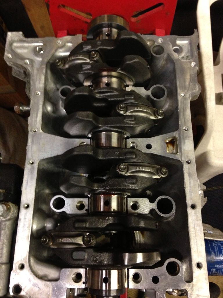

I collected a full set of cosworth bearings on friday too and have now set about plastigauge'ing them to set my clearances. Nice new bearings.
Crank carefully placed in the block.

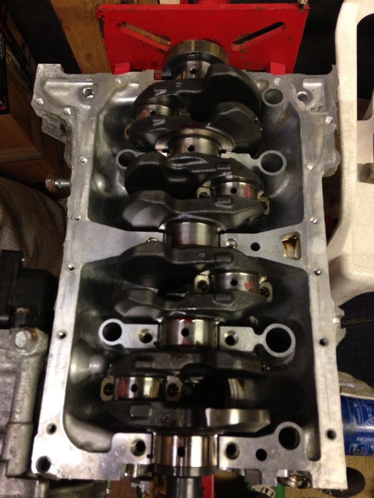

And the result after torquing the cradle down and then removing it - the plastigauge is squashed and I can measure the tolerances.
Thats the mains done, next i'll do the big ends. Once they're OK i've got all the bits I need to put the engine back together so i'll be dropping it in the car over christmas.

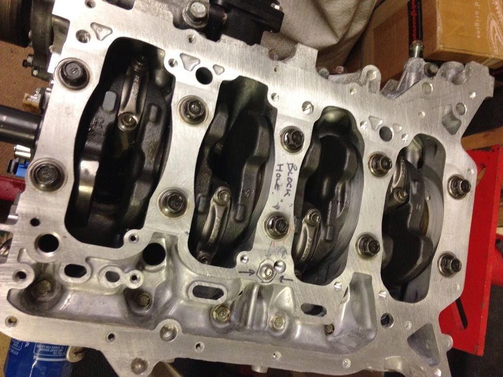

Spent a very therapeutic couple of hours in the shed just. After using the plastigauge on the big ends and mains, my big ends were a little sloppy (ooh err) so I exchanged a half set of bearings to get the desired clearance of just under 2 thou. I rechecked them and they're now spot on.

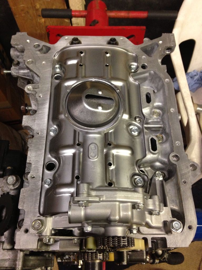

So with all of the bearing clearances set, and my crank ladder machined to accept the earlier style oil pump, it was time to torque it all back up finally I actually had to buy a new torque wrench for this engine as my existing one didn't go down low enough. Rods are torqued to 22lb ft + 90°
Followed by the crank ladder which is 22lb ft + 56° and sealed using genuine hondabond silicone.

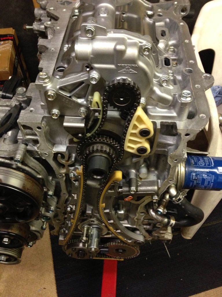

From there its a pretty straight forward job to install the oil pump, windage tray, chains and tensioners.

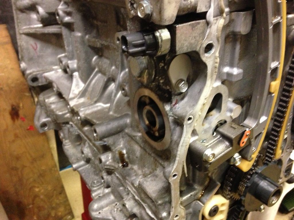

I keep talking myself into buying more shiny trinkets from Ian at Clockwise, so i've got these two little blanking plates to delete the water hose that runs through the standard oil filter housing, as i'll be using a remote and a cooler.
