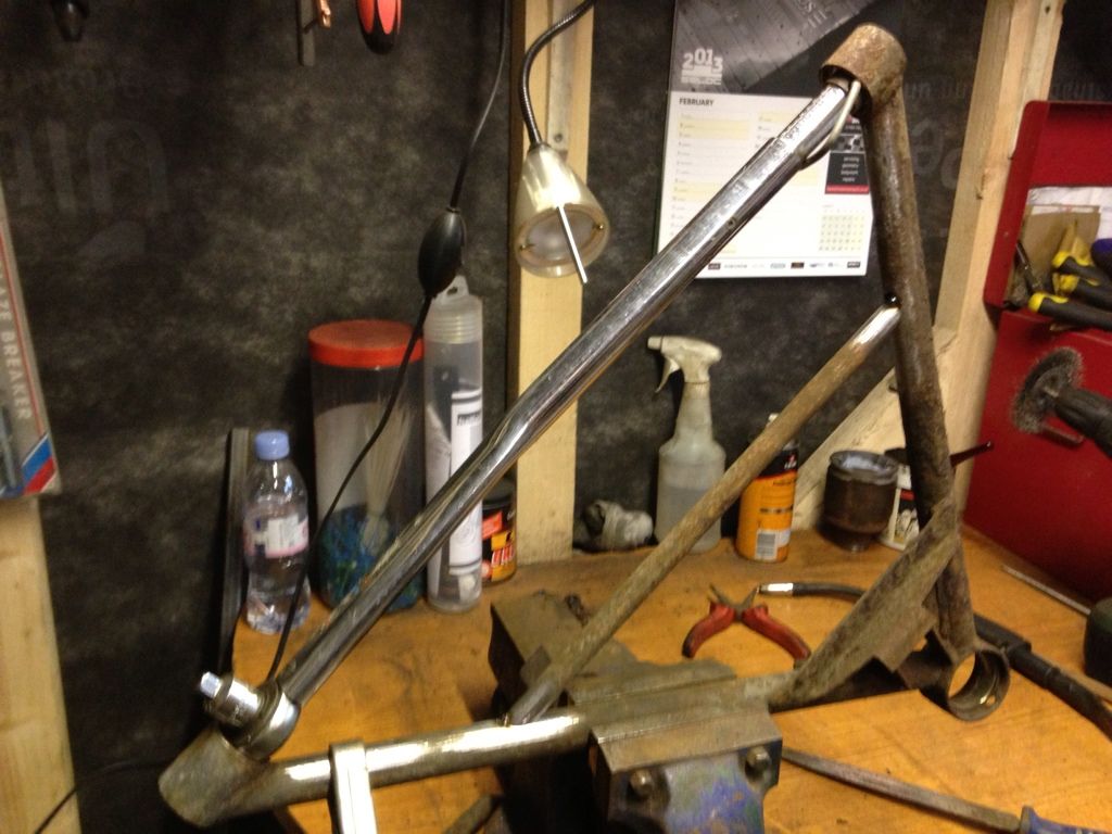

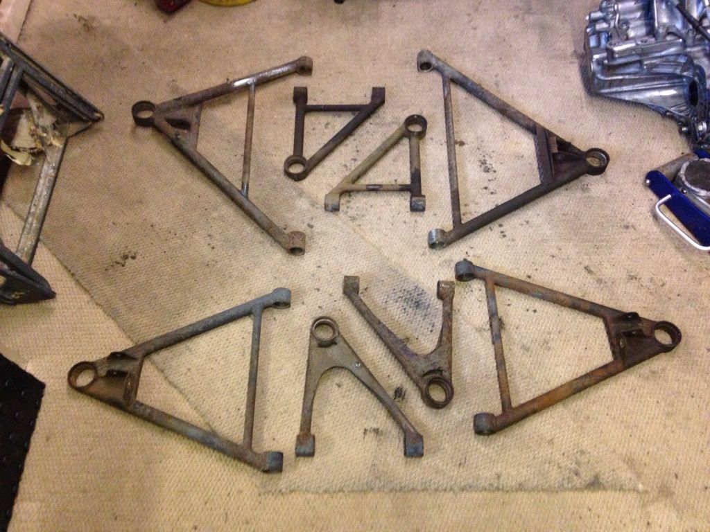

While I have a drink and a bite to eat I will update today's progress so far. I have to modify one of my wishbones for this conversion, moving the cross brace further towards the ball joint end for clearance, so I set about it with a hacksaw. As I sawed through one end, the arms of the wishbone sprang together so they were obviously under a little tension. In order to make sure I got them back in the right place I used this ingenious method to spring them apart and measure against the other wishbone.
Then set about welding the brace back in and I must say it was probably the best bit of welding I've ever done, which isn't saying much as it usually looks like a flock of passing seagulls did it.
And so here we have a full set of wishbones ready to be blasted and painted.

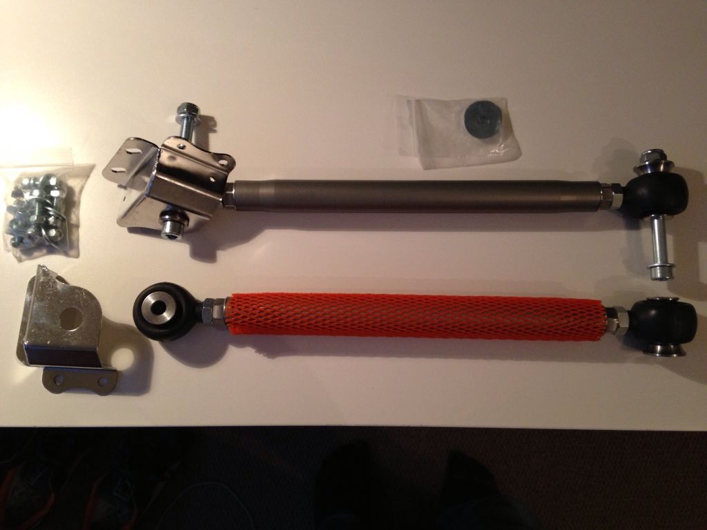

Oh hello
Posted on Thursday, February 14, 2013 at 4:42 PM
Elise parts toe links? Next stop for my car before it goes on track
Posted on Thursday, February 14, 2013 at 4:47 PM
Posts: 6848
Spitfire engineering...nicer than the EP items in my humble opinion!

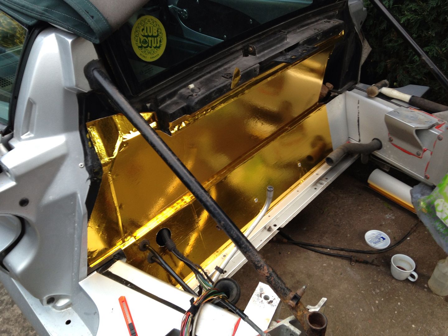

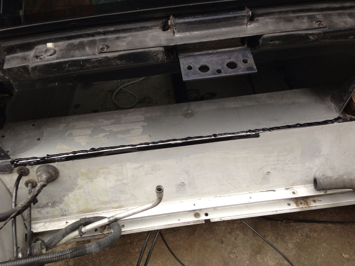

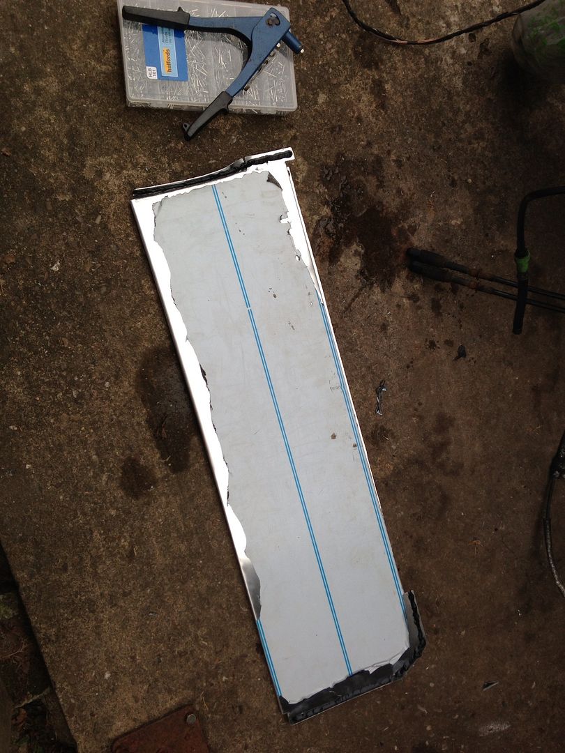

Custom made using honda outer cv's and bespoke drive flanges. So, after a couple of days mountain biking in snowdonia, I'm hard at work. First job of the day was the bulkhead, the potential for this to go horribly wrong was massive  I got a good bead of my chosen bonding agent on it...
And the same on the chassis....

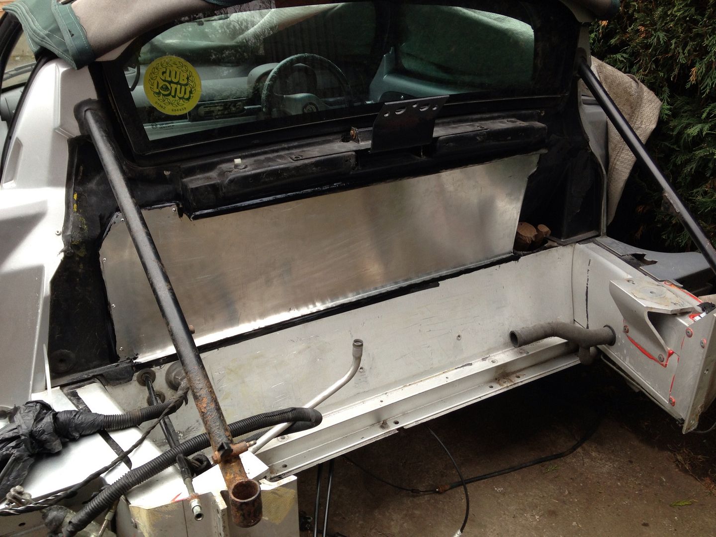

But I was worrying about nothing, after a few taps and a handful of rivets we now have a bulkhead
Bit of tidying up of the excess sealant and jobs a good'un.

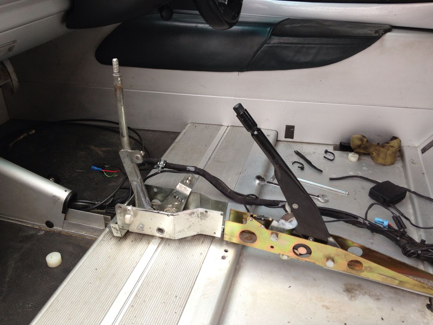

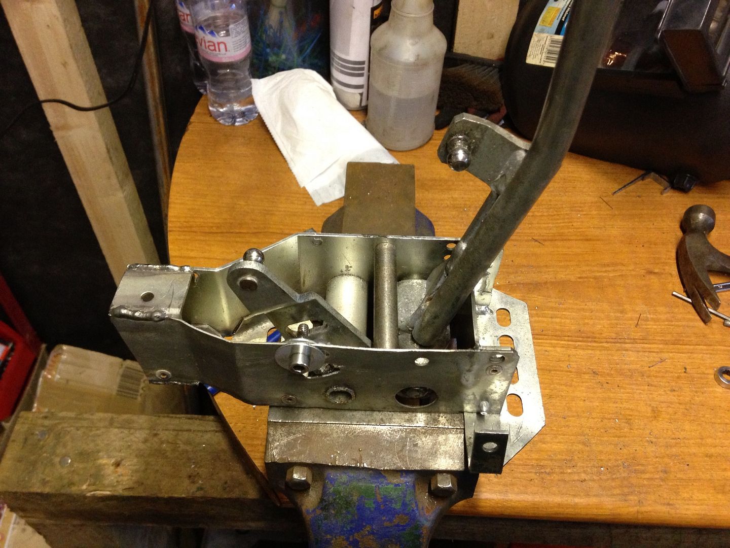

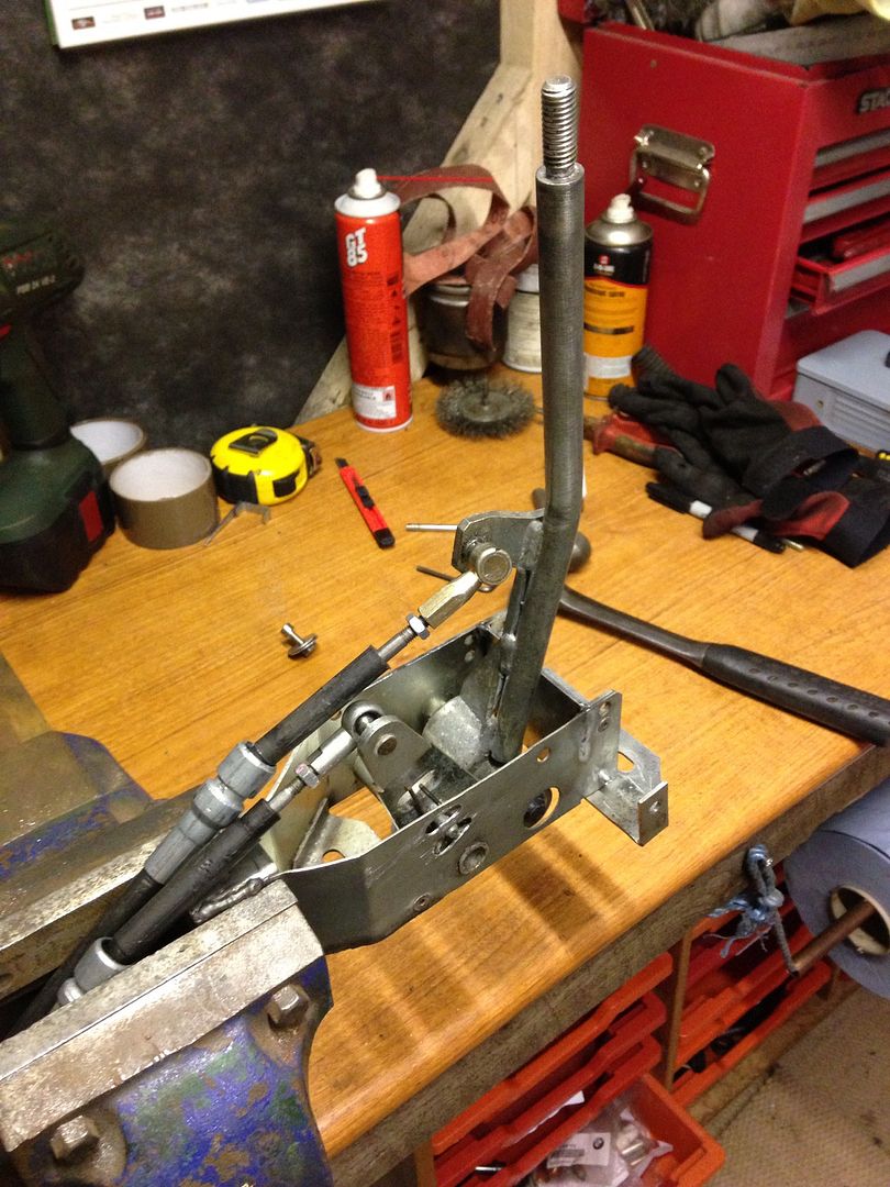

Whilst I was waiting for the bonding to dry I started to play with my gear linkage. The new linkage came as a complete unit with hand brake as well, where as the s1 linkage is separate to the handbrake, so I cut it in half and offered it up....s1 handbrake, s2 gear linkage:
I have to modify this slightly for cross gate movement, as reverse is in a different place but that's no problem. Whilst doing this I realised that the linkage is made from some horrible flimsy tin and has an enormous amount of flex, so I set about bracing and welding all the seams. It's now very stirdy - I intend for the quality of the shift to be as good as I can possibly get it as its an important part of the driving experience.
And here it is in place - I think this is going to be excellent

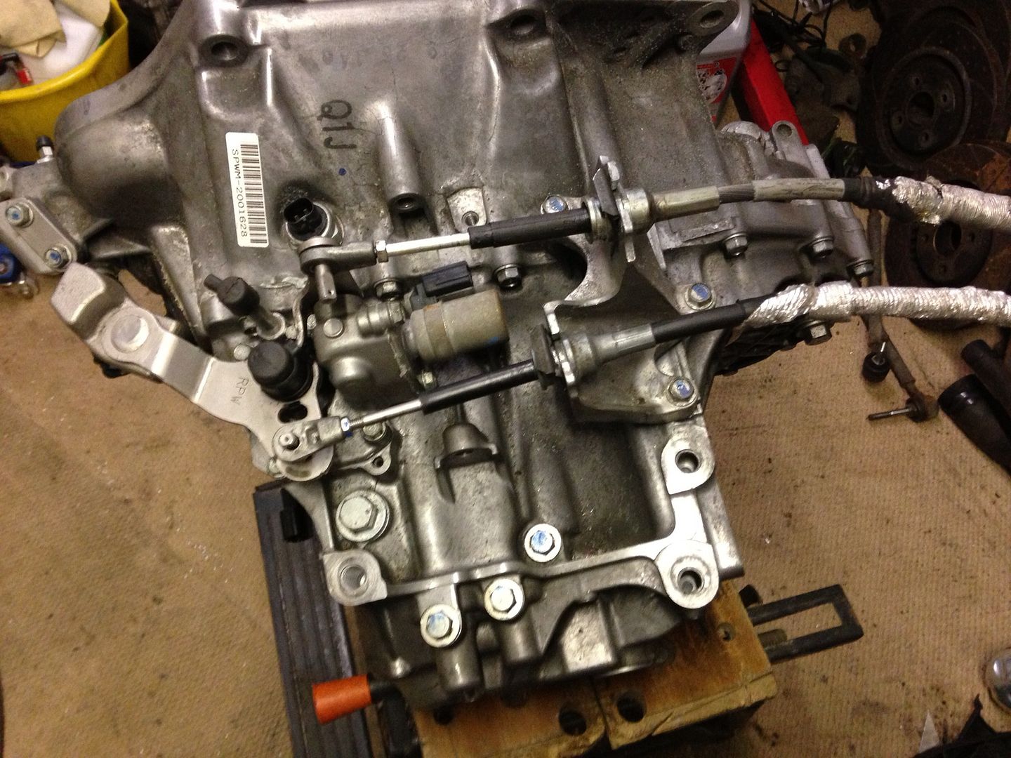

At the gearbox end you mean? None required as i'm using the later Z spec box, so its a direct cable connection. Its going to be an awesome quality gear change I think
Posted on Wednesday, February 20, 2013 at 7:10 PM
Posts: 6845
Yeah, z spec box what's that
Posted on Wednesday, February 20, 2013 at 8:54 PM
Posts: 6848
I have a K20z4 as fitted to the latest civic type R, you have a K20a as fitted to the old bread van shape. Z spec box with cables attached...
Direct to the gear stick, no additional linkage required...
It feels good, with the mods I've done I'd say on a par with the S2K...

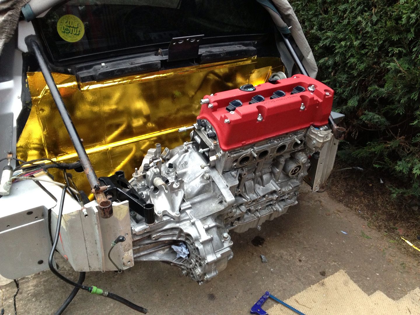

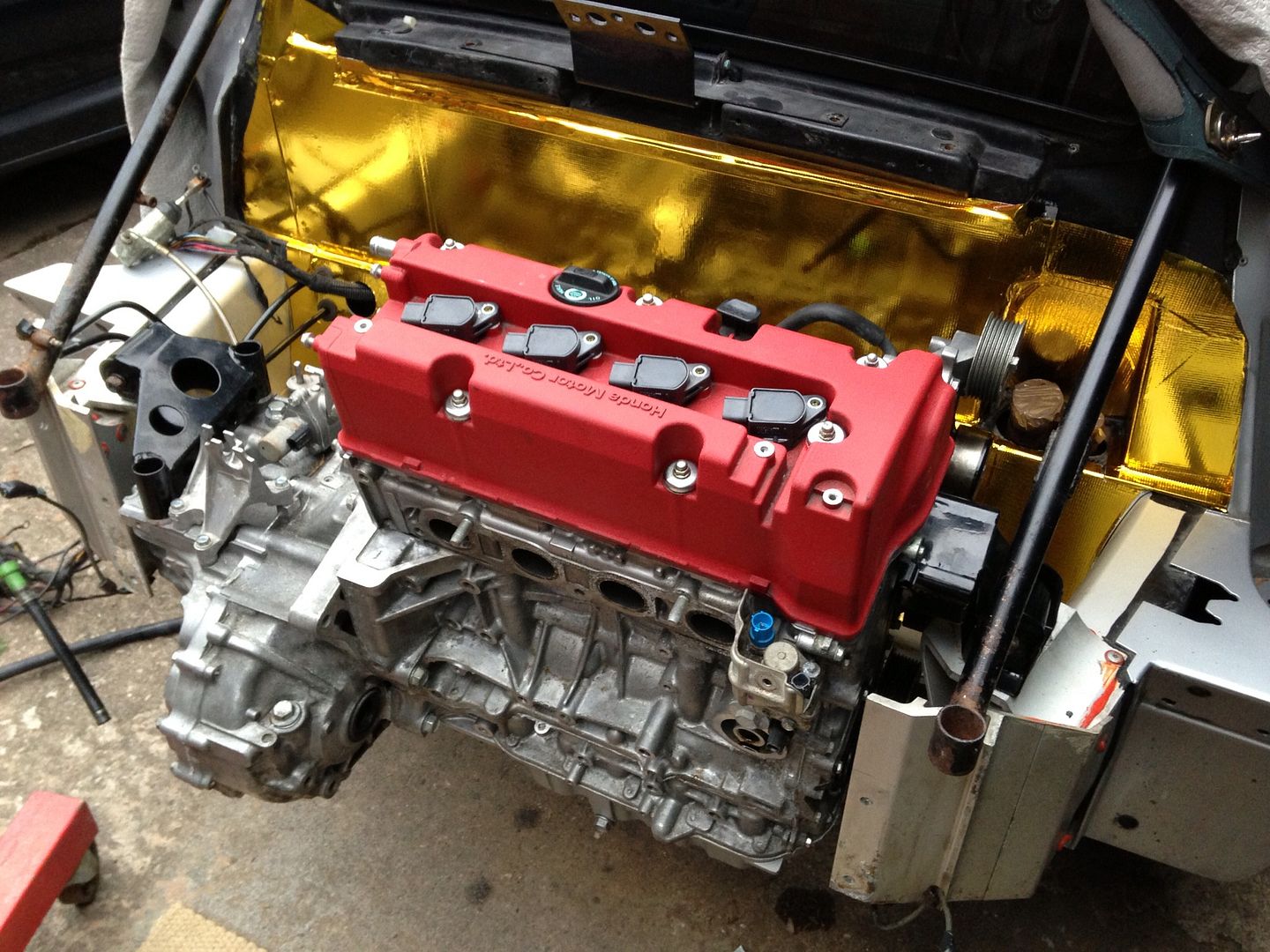

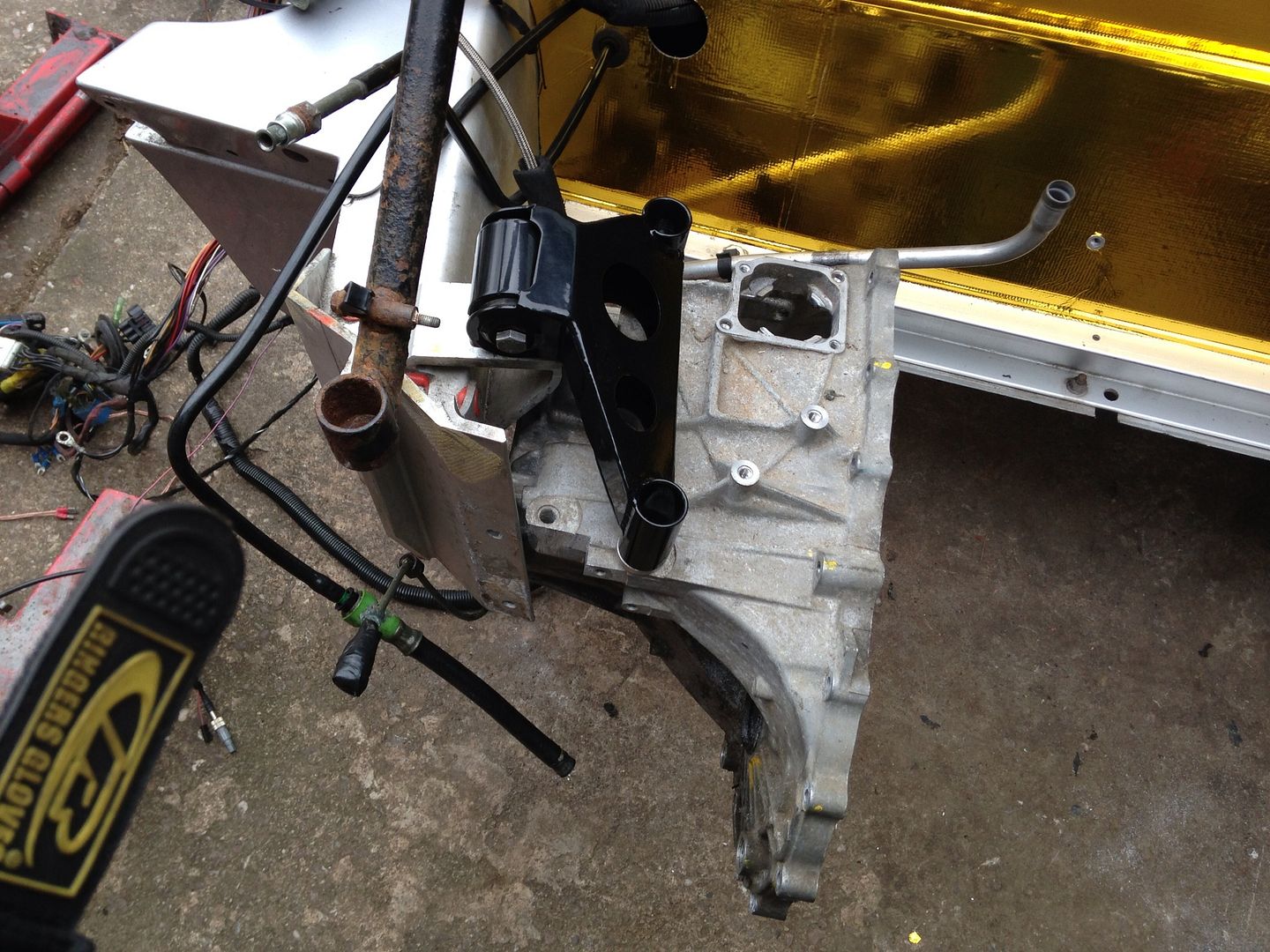

A quick test fit of the spare gearbox case I had...
And hey presto, we have a car with an engine.
Please excuse the bolts, they're temporary...
