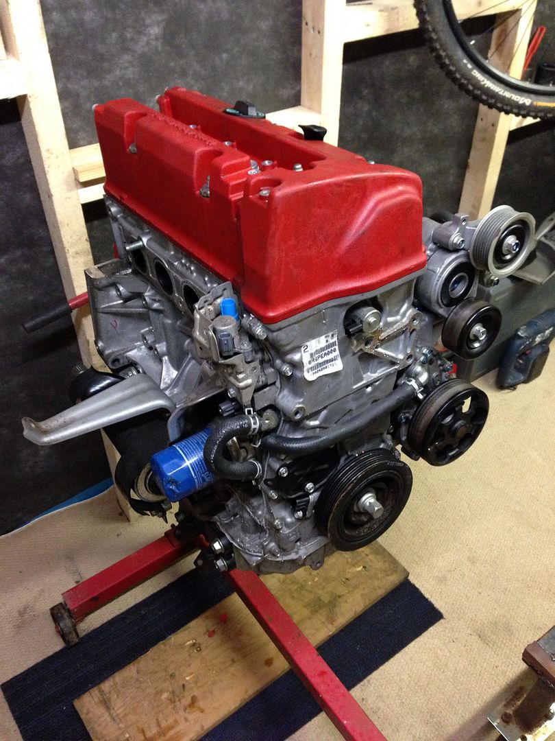

Engine on the stand.
I don't plan on doing a great deal to this engine yet, it does need a shallower sump and different oil pump and also the balance shafts deleted. I'm also in two minds currently over whether to stick with my original plan for an RBC manifold and throttle body or just put individual throttle bodies on it. I know what I'd rather do but the cost may be prohibitive.

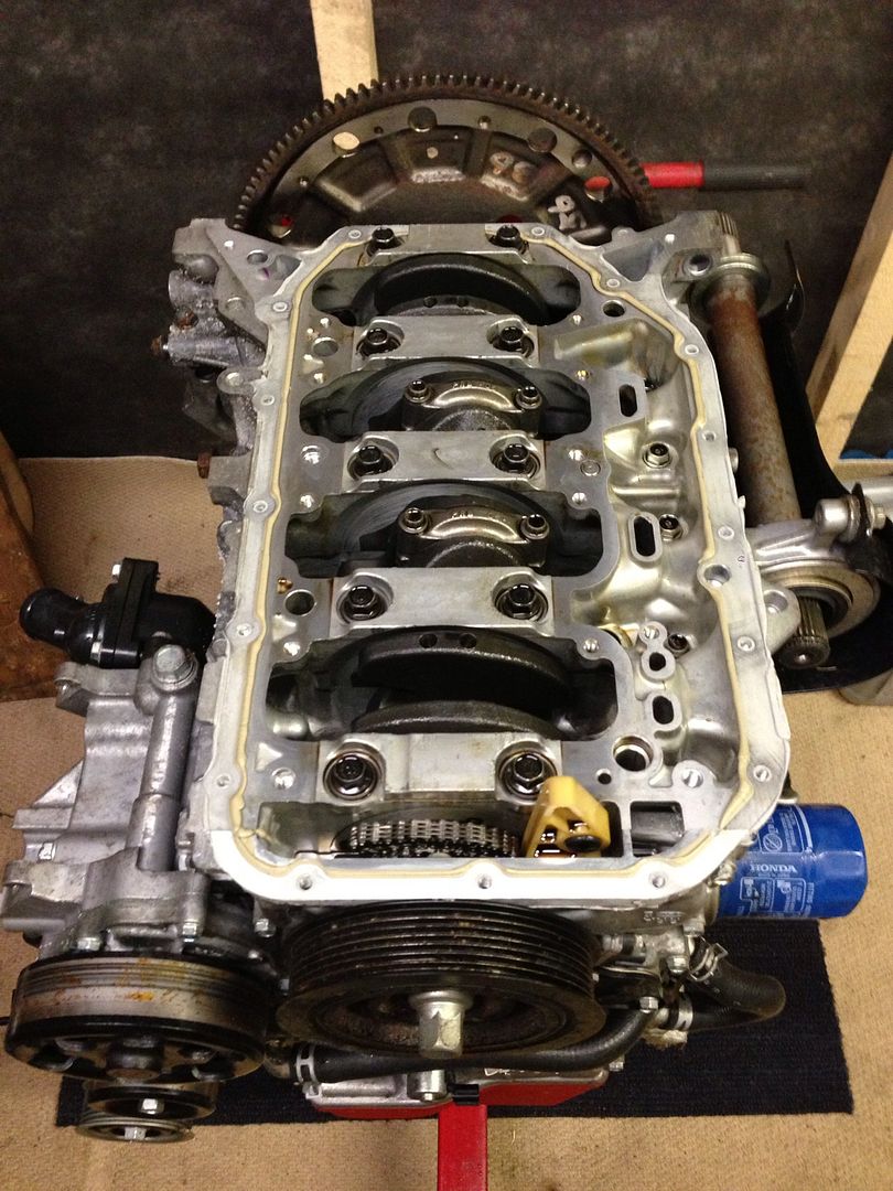

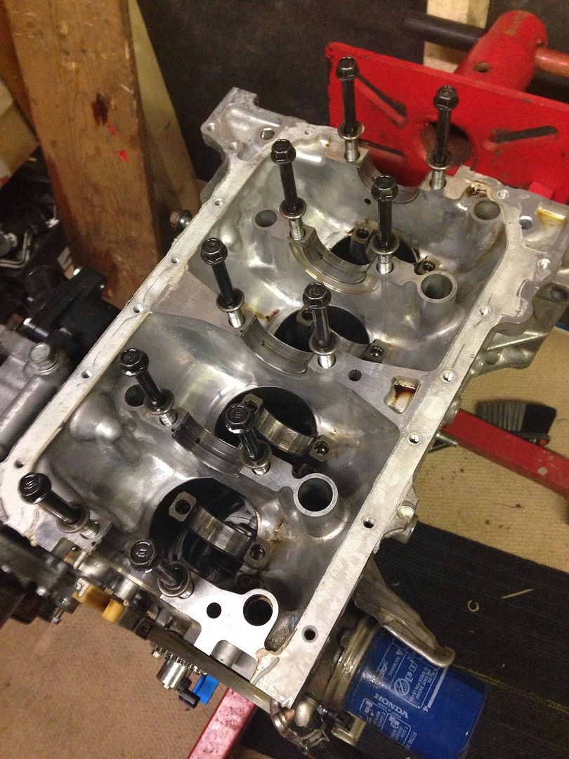

Rightio....in order to fit the shallower sump and delete the balance shafts I have to remove the crank cradle and machine part of it down to clear the pump so I've stripped the engine down.

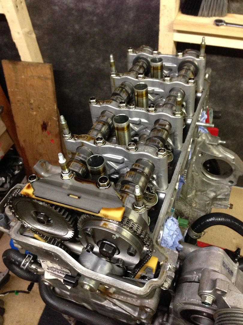

Here's what the inside of your head looks like....
Lovely timing chain, no more cam belt to worry about.
Crank out and cradle ready to machine.

Despite the low miles its evident that some kind of debris has found its way into the oil of my honda engine as one of the mains has a nasty score in it and there is evidence that whatever it was made its way through the other 4 too. So, i'm replacing the mains and the big ends while I have the engine apart.
I've had the cradle machined so I can reassemble the engine once i've plastigauge'd the bearings.

A written off type R, engine was bought by clockwise / bespoke engineering as a job lot of 4 or 5 engines at the time. Its pretty immaculate apart from the above - you can see its done very little work.
The scoring is nasty by my standards - ie. almost nothing at all, its probably just been ragged from cold with a smidgen of dust in there. I'm changing the mains and big ends anyway as I wouldn't be able to sleep at night if I didn't. Lesser folks might just put it back together as is.
