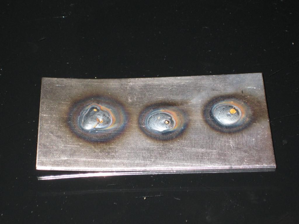

Spot welds in 2 bits of 1mm steel (I had to have a second shot at the far left one)

You're not going to get your own spot welder are you? Good skillz anyway 8)
Those aren't done with a spot welder - top layer drilled out with a 6mm hole. Two layers clamped together, then hole filled centre-out in a kind of swirling motion (I would have said just like icing a cupcake, but there was a bit too much weegie testosterone floating about for a comment like that ;))
