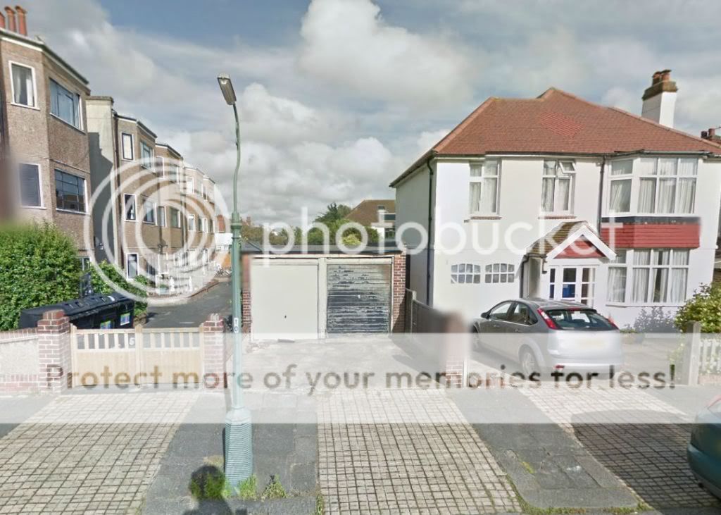

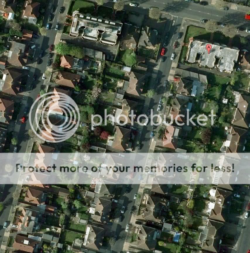

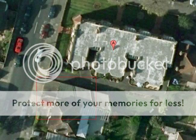

Here's a couple of pics from Google maps, showing their proximity to a block of flats and the adjacent house. Also the aerial view which shows garages.
Any thoughts?

Looks very much like there's a building line which would prevent you building in front of the existing garage doors, which would restrict the useable area of the plot. How tightly packed are houses generally in the vicinity?

Forgive my ignorance. I'm guessing when you say builidng line that you mean the fronts of the buildings must line up?
Here is a broader view of the area.....they are all large(ish) semi's, evenly spaced and not particularly cramped. It's a nice road as it goes.

It would be tricky as you're pretty close to the flats that are facing you, strictly speaking you shouldn't build within 21m of these and you certainly wouldn't be allowed any windows on the side of your building or at best totally obscured glazing.
You might get it through if you had a good case for it but you want to get some good planning advice before getting your chequebook out.
Yes, that's exactly it - the fact that the houses and the flats are all set back the same amount from the road itself indicates that you'd not get permission to build forward of that line.
