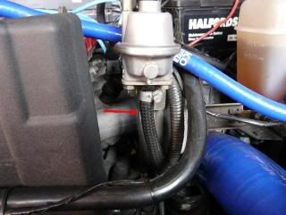

As the weather was so good this afternoon, I thought I'd roll the Sierra out its nest and give it a run round - it's been grotty weather for the last week so I guessed I had better make the most of the sun.
Last time I used it I got the odd whiff of petrol on the over-run but couldn't see/smell where it was coming from at standstill. As I started it up today, I could see the fabric braided pipe under the fpr was damp so off it came.....
.....and on with some new pipe and clips .
Checked all the others over but they seemed OK, probably not subject to quite the same heat extremes as that one. Obviously a combination of that and the HIGH PRESSURE from my Bosch 044 pump have taken their toll. Will do the others in the next couple of weeks as contingency anyway So about 45 minutes later I was up and running again
 Took it for a good blast round some local roads and a bit of bypass and it seems to all be in good order. No fuel whiffs or leaks now - a good time had by all
